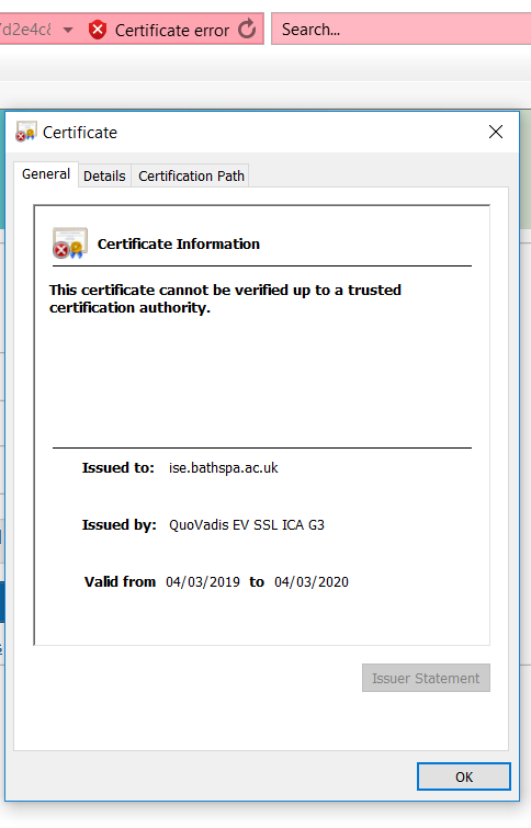

We have imported the full certificate chain that has been signed by a CA authority & bound the original cert request. It has being used by the default portal certificate group and we can confirm in the browser when redirected that is is using this certificate but it is still saying it is not trusted.
Does your client computer have the QuoVadis EV SSL ICA G3 certificate in it's machine store?
No it doesn't
That QuoVadis certificate needs to be imported to the computer trusted certificate store, otherwise the web browser will consider it untrusted and error.
