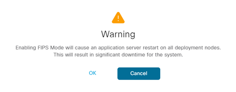

Impacts of Enabling FIPS:
1st "... will cause an Application Server restart on ALL Deployment Nodes ...":
IMPORTANT: FIPS can not be enabled until you remove/edited ALL Allowed Protocols configured to use non-FIPS Compliant ... after FIPS Mode = Enabled and after clicking the Save button, you are able to check the non-FIPS Compliant protocols?
