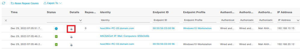

Look at the following screenshot:
In the above scenario, the "Win-PC-02" is connected to an interface that belongs to VLAN 20. After authentication, proper authorization policy applied to that interface which changes the VLAN of it to 10. So, although the client has successfully assigned IP address in VLAN 20, after applying proper authorization policy it changed its address to something in VLAN 10.
Now I decide to see the detail authentication report for the following operation:

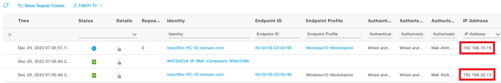

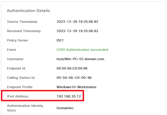

As you can see above, under the "IP Address" column, we see "192.168.10.15", but in the report:
I use ISE 3.2 Patch 4.
Any ideas?

From what you described above, it looks expected. Before the PC authenticates, it receives the IP address from VLAN 20 so it sends this as part of the authentication request. After it authorizes, it moves to VLAN 10 and receives the new IP assignment. At this point, the switch sends the accounting request(s) to update the client IP address but not another authentication request so the authentication report will show the IP from VLAN 10 instead of VLAN 20. If you check the RADIUS accounting reports, you should be able to see one to update the client IP.

ISE learns about the endpoint's IPv4 address via the IOS Device Tracking feature (should always be enabled) - even if you are not using DHCP, device-tracking will issue a regular gratuitous ARP to get the IPv4 address of the endpoint. In the case of IPv6, it can glean addresses from the ND messages.
show ip device-tracking database int x/y/z
However, I agree with you @rezaalikhani , that when you click on the details of one of the rows in Live Logs, that the IP addressing data should correspond. I think that ISE does some caching behind the scenes and I know that the "blue dot" icon LiveLog entries (Session records) typically don't include updated RADIUS attribute data - they take their data from the original/first Authentication.
Have you tried the same test with Successful Repeated Auths suppression disabled? Worth a try - but like I said, the blue dot indicates an Accounting record was received, and then ISE cheats a little (or, it chooses to be lazy) with the data it chooses to present.
