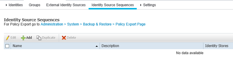

Performed migration from ACS 5.8 to ISE 2.4 using MigTool. Shows that all the "Identity Source Sequence" have been migrated but they are not showing up in ISE.

ISE:
But if I go and try to create New Identity source sequece manually, Identity source attribute are there:
2 Accepted Solutions

Looks like something is wrong in the database itself. Please open a TAC case to get to the bottom of this.
It seems like a bug. A ticket has been opened with Cisco TAC.
