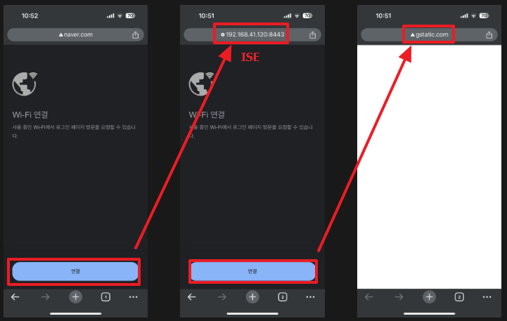

02-12-2024 06:46 PM - edited 02-12-2024 07:44 PM
@Arne Bier @Greg Gibbs @Ruben Cocheno
Adding gstatic.com to the URL Filter and attempting to access the internet from a Chrome browser redirects to the BYOD Portal.
The redirect to BYOD Portal succeeds regardless of whether Captive Portal Bypass is enabled/disabled on the controller.
When press Start in the BYOD portal on a Chrome browser, show the message "This browser is not currently supported"
However, it does not redirect to the BYOD Portal in Safari browser.
What do I need to do?

02-12-2024 07:56 PM
@JustTakeTheFirstStep , the URLs defined in URL filter defines what traffic will be exempted from redirection. If you want the redirect to happen when the browser is directed to 'gstatic.com' then you would not want that defined in the URL filter.
The expected behaviour (and what I see in my lab with my iPad [OS 17.2] and ISE 3.2 is the following:
- With captive portal bypass disabled, the redirect happens and the ISE portal returns the error 'This browser is not currently supported'
- With capture portal bypass enabled, after the initial SSID connection, the user must manually open a browser and input a URL that initiates the redirect (I use 'http://neverssl.com' as HTTPS redirects can be problematic). At that point the redirect happens and the BYOD enrolment flow can be followed.

02-12-2024 09:23 PM - edited 02-12-2024 09:27 PM
Removed gstatic.com from the URL filter.
Wich Captive portal bypass disabled,
not automatically ridirected. manually opened the browser and entered the URL to start the redirect. show the message "This browser is not currently supported"
Wich Captive portal bypass enabled,

02-13-2024 01:29 PM - edited 02-13-2024 01:29 PM
I can't replicate this issue in my lab (which is using an AireOS WLC). You might need to open a TAC case to investigate in more detail.
