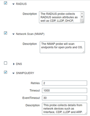

hi Marcelo,
DHCP, RADIUS and SNMP Query are all enabled. But the switch to which my endpoint is connecting is mainly working on Radius with ISE.
I'm not sure if "Attributes" highlighted by red circle in the snapshot below is what you want me to check. If so, there are lots of attributes in this page. and no Framed-IP-Address, dhcp-requested-address or SNMP polling attribute show up there.
what else can I check for further? Thanks a lot.

Hi Marcelo,
Actually the endpoint and ISE are deployed in VM. I think this is why Endpoint Profile shows VMWare-Device. ISE should be OK to work with an endpoint in VM environment. And currently I deployed only one endpoint in VM.
As you saw, Current IP Address is empty in my snapshot. There is also no Framed IP Address showed up. How can I get Framed IP Address? Especially my switch is from other vendor rather than Cisco.
