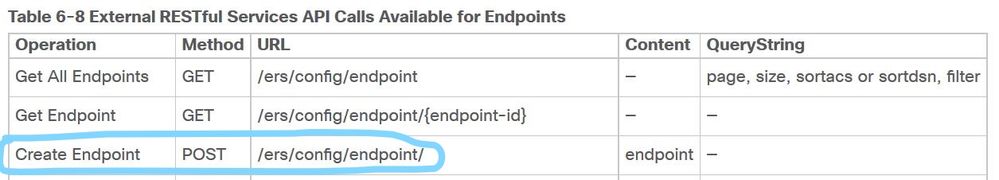

Question1:  What is correct method to be used in order to insert a new MAC address ( API function PUT:endpoint register or POST:endpoint create )?
Question2: Why is the attribute ‘id’ required by the documentation as a new MAC address can not have a ‘id’ because it is not known yet by the ISE system?
(I try to find on this forum an eindpoint insert example but I could not find it)
Question3: When a MAC adres is inserted into the ISE database via de PUT:endpoint register function, why is an “Exeed allowed License usage (PLUS license) warning generated?
In order to slay the 405 dragon, I build a very simple ERS create endpoint python script without any further functions based on following ref guide;

So the big question stays why I get these 405 errors ?
405 Method Not Allowed - The HTTP verb specified in the request (DELETE, GET, HEAD, POST, PUT) is not supported for this request URI.)
 As it clearly state in the ref guide that a POST method ,ust be used ?

It's a POST you should use, Endpoint Group is not identified in the xml by name, but by id, which you can obtain by getting the list of groups (send a GET to https://ise:9060/ers/config/endpointgroup) Just put something in id and name, doesn't matter, won't be used. xxx-xxx-xxx-xxx-xxx 11:22:33:44:55:66 true false

Which looks fine, but if the option in curl  -d xmldata is supposed to reference a file, you need a @ in front of the filename. If you are not using a file for your xml data, then maybe try that?
Jan,  thanks for your support It pointed me into the correct direction, so both the CURL and the python script option is now working.
Btw>  I noticed that the a endpoint by default is not assigned to an endpoint profileId, but by using the CURL command it was no problem to obtain the endpointgroup id and apply that information in the create profileID value.  So I be able to create an endpoint, put it in the correct group with the GroupId and profiled it to the correct profilename.
Many thanks,
With kind regards Michel
