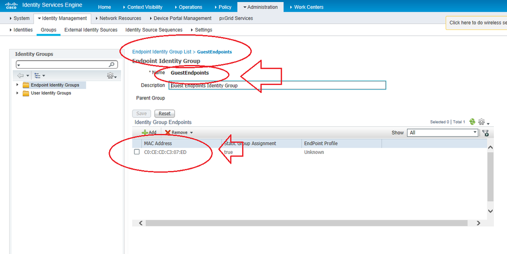

Hi Josh,
I have an answer for you BUT the purge process on ISE sometimes does not work as expected so you need to give a try to that part. I am NOT using CWA for Guest access and I am forcing them to accept the AUP Page with the decline button provided by the customized portal. In addition to that, using the GUEST TYPE/Sponsor Group you can assign an specific Guest Account to an Endpoint Group once the guest is authenticated. See the following screenshot sequence.
1.-The  AD Sponsor Group should create a guest type account which would point to an specific Endpoint Group. That means, you probably need multiple type of guest accounts for different administrators (AD Groups).
2.-You need to enable automatic Endpoint Group registration for the Guest Portal
3.-Once the Guest user is authenticated. (I AM NOT USING CWA)..The MAC is added to the expected Endpoint Group.
4.-For the purge process , try something like the following BUT I have seen issues with that on ISE.
5.-I am using the DECLINE button in the AUP Page so all the Guest are required to accept that page. It does not affect the Endpoint Group registration for the Guest device.
