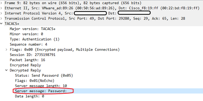

Just checking - you changed the text below in your ISE from "Password:" to something like "OTP Challenge" ?
I replicated how working ISE in my case.
cisco-av-pair setting:
cisco-av-pair = ACS:CiscoSecure-Group-Id=OTP-test
RADIUS_OTP_test server reply:
Password prompt setting:
TACACS+ server reply:
Telnet successfull login:
but password prompt has not changed.

What does this screen look like on your ISE?
ISE is working for me, even with SSH.
I found the custom prompt ("Duo AD-Pass:") shown in the T+ server reply.
