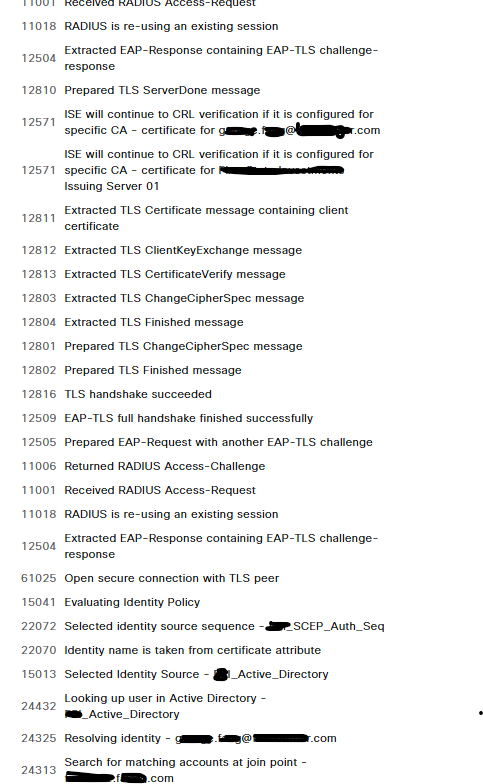

Recently we renewed our Root CA certificates and Intermediate CA certificates, we didn't uploaded them to our ISE server. While all devices with new certificates or old ones are working. Just curious it seems didn't verify the certificate chain of trust, and it mainly verified the Common Name(username) in AD.

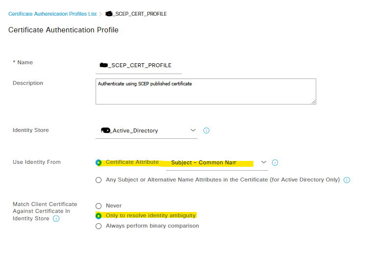

  The settings are

3. the below is Authentication logs, it looks ISE will only use the uploaded Intermediate CA certificates for CRL verification, and then select Common Name from the SCEP certificate to verify it in AD.
Looks ISE didn't verify the chain of trust, as new SCEP certificates pointing to new Root CA will still get allowed. It only do CRL verification via old intermediate CA certificate.(I think the CRL didn't change during our Root CA renew).

CRL downloads use http (TCP/80) and there is no transport security involved - therefore, no certs/SSL involved here.
I'm struggling to understand the issue - there is no danger whatsoever in installing the new Root CA and its new Intermediate CA certs - just be sure to tick the right boxes to ensure they are used for Endpoint auth.  On the Issuing CA certs, you can (or should) set the CRL URL manually, since ISE doesn't look in the client cert's CDP (CRL Distribution Point) to pick out the http URL - in the past, I noticed that it would pick the LDAP URL (if the CA is a Windows box) and then fail spectacularly.
Also, are you sure that you want to perform an AD lookup of the user's cert, for each EAP-TLS authentication?   It's not technically required, and I don't know if you have read into the pros and cons of doing this - happy to be corrected on the merits of doing this. But generally, if ISE is performing the cryptographic checks for the cert's authentication, then the authentication is done (in my opinion) and needs no further checks - the Authorization can of course (and often is) performed by looking up the Identity in that cert (from the Subject CN or SAN) to query AD Group membership etc.
