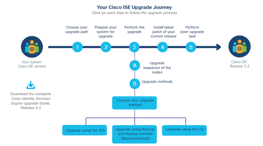

5th you can upgrade via CLI or GUI (check the Cisco ISE Journey for Release 3.3) and choose your upgrade sequence of the Nodes, please take a look at:

Hi @manvik ,
 if you "detach" ISE Node (de-register the Secondary Node from Primary), your Small Deployment will become two Standalone Deployment., after that you are able to upgrade one Standalone Deployment to ISE 3.3 Patch 2 and double check if everything is fine before upgrade the other Standalone Deployment.
