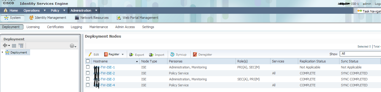

We have deployed 04 ISE nodes in the following senario. (ISE ver 1.1.2.245)
1 ISE - Primary (A) Secondary (M)
2 ISE - Primary (M) Secondary (A)
3 ISE -  Policy Service (PDP)
4 ISE -  Policy Service (PDP)

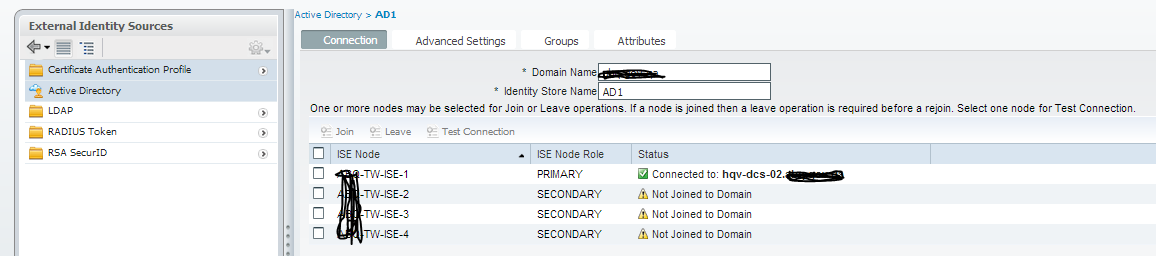

When integrating with AD, we can only integrat to the 1 ISE only. NTP, Timezone, DNS working on all 04 boxes perfectly. We are getting the attached error while integrating AD with other ISE nodes.
In the above senario, what ISE nodes should have the AD joined, only the PDP or all 04 nodes should have joined..?
Can someone please advise. Please see the attached screenprints for the deployment and detailed error while joining to AD.
Thanks in advance.

To answer your question: You need to join your PDP nodes for user/machine authentications coming from NAD devices (Switches, Firewalls, WLCs, etc). If you want to integrate ISE admin, lobby admin to AD then you need the Admin nodes joined as well.
For the AD join error: Can you bump up the logging to "debugging" for AD and post the outputs from the log file again? Also, did you make sure that you have the proper permissions for the AD account that you are trying to use to join the nodes?

636 (TCP)
• The Active Directory username that you provide while joining to an Active Directory domain should
be predefined in Active Directory and should have any one of the following permissions:
– Add the workstation to the domain to which you are trying to connect.
– On the computer where the Cisco ISE account was created, establish permissions for creating
computer objects or deleting computer objects before you join Cisco ISE to the domain.
– Permissions for searching users and groups that are required for authentication.
After you join your Cisco ISE server to the Active Directory domain, you might still need the
permissions discussed previously to do the following:
– Join any secondary Cisco ISE servers to this domain
– Back up or restore data
– Upgrade the Cisco ISE to a higher version if the upgrade process involves backup and restore
• If your Cisco ISE deployment has multiple nodes in a distributed setup, you must first define the
Active Directory domain on the primary administration node and then explicitly join each of the
secondary policy service nodes to that domain.
• Every Cisco ISE administrator account is assigned one or more administrative roles. To perform the
operations that are described in the following procedures, you must have one of the following roles
assigned: Super Admin or System Admin
• Ensure that your Microsoft Active Directory Server does not reside behind a network address
translator and does not have a Network Address Translation (NAT) address. “

In addition to what everyone has posted above you can also check the following:
From the command line run a nslookup of your domain.  Ensure that all NS records are your correct domain controllers and that they are active.  Remove any NS records for domain controller that are no longer active.
Kyle
Hi Kyle,
When we give nslookup on ISE CLI, it resolve the ip address on all ISE nodes..
I have open a TAC case and we are working on this and will update once fixed.
