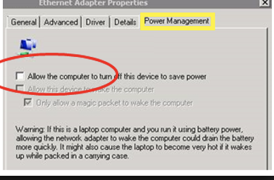

Hi, I suggest disabling wake on LAN if you're not using, actually disable all the power options on the NIC, seems like there's an issue with 802.1x and the power feature on windows machines.
I have disabled this for the entire company (your windows admins can do this via gpo/sccm)
From the Device Manager, right-click on the NIC and disable power options (all of them, not just wake on LAN) This saved me a lot of pain.
