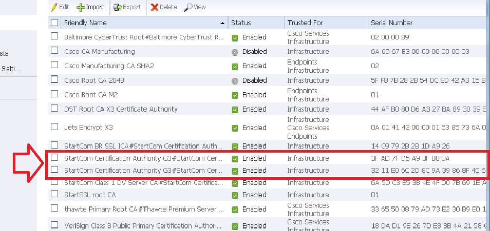

Based on my understanding, you were using starcom certificates before and replaced them with the let's encrypt x3. When you replaced the certs, the application services are restarted. SO if you were using before one of the following highlighted certs and BOTH with the same CN, then it is quite possible your internal Cert DB is corrupted but it can be easily fixed. Please confirm if both certs has the same CN (posts an screenshot with the CN displayed for both).
The upper certificate (serial number 3F AD 7F D6 A9 BF B8 3A) has
subject = CN=StartCom Certification Authority G3,O=StartCom CA,C=ES
issuer = CN=StartCom Certification Authority G3,O=StartCom CA,C=ES
valid = Wed, 22 Mar 2017 07:19:56 UTC -- Sat, 22 Mar 2042 07:17:58 UTC
The second certificate (serial number 32 11 E0 6C 2D 8C 9A 39 86 8F 40 60 78 3C B6 01) has
issuer = CN=StartCom Certification Authority,OU=Secure Digital Certificate Signing,O=StartCom Ltd.,C=IL
valid = Tue, 11 Apr 2017 07:30:01 UTC -- Mon, 11 Apr 2022 07:30:01 UTC
So in spite of different issuers etc., the subjects are indeed identical, as you suspected ...
If this means the Cert DB is corrupted, how can it be fixed? Since they are obsolete, it wouldn't be a problem if we remove all StartCom certs in doing so.
