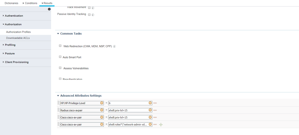

For a customer PoC I have a pair of ISE installed and have added several network devices (e.g Cisco, Arista, F5, Aruba, and HP) for device administration where some are administrated viaTACACS+ and some over RADIUS. The goal here is to replace an old ACS system and an old RADIUS Server (FREE-RADIUS).
My particular issue is currently the HP switches. I have set up all necessary attributes and settings on the ISE, like for the other vendors. But on the HP I not getting any success.
On the ISE I see the authentication, authorization steps with full success, but the switch tells me permission denied, which is wired. On the old RADIUS system (FREE_RADIUS), my customer is using the Cisco attributes for all HP switches and it works fine there.
I found out if I'm leaving out the "aaa authentication login privilege-mode"  command, the given attributes on the ISE seems to work. But I will have to authenticate one time for the level 0  and then again for the enable mode level 15  which I want to avoid and is not used on my customer's environment.

Attributes I have used and tried:

Have you tried 'roles=' instead of 'roles*'? Also, you could try with single role 'shell:roles=network-admin' instead and see if it gives any hints.
I finally find a solution. Changed the equal sign to the star which has helped and added and IETF attribute service-type=6.
This finally helped and now it is working as expected.
Access Type = ACCESS_ACCEPT
Service-Type = 6
cisco-av-pair = shell:priv-lvl=15
cisco-av-pair = shell:roles*"network-admin vdc-admin\"

Do you have list of attributes the FreeRADIUS us sending back? I would match exactly how it is setup on FreeRADIUS. Also, packet capture of what is being sent back from FreeRADIUS would work as well.
I did exactly the same as you proposed.
That are a dump from the FREE-RADIUS
