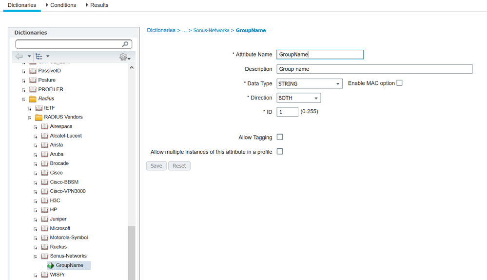

Hi Arne,
Thanks for your response
Please find the screenshot of Sonus dictionary attribute:
I have created following authorization profile
and the screenshot of authorization rule:
I added NAS with device profile "Cisco" and Result Profile is also "Cisco". But still it is failing
Looks like this is a custom dictionary. Did you contact Sonus TAC on what they would be expecting from the RADIUS server ?
This is a custom dictionary.

In got ISE to send the attribute as per the document. See below:
[cid:image001.png@01D4A9CE.5EC23510]
[cid:image002.png@01D4A9CE.5EC23510]
[cid:image003.png@01D4A9CE.5EC23510]
[cid:image004.png@01D4A9CE.5EC23510]

Hi All,
We got it working...
TAC Engineer created a separate Network Device Profile.
Assigned this profile in device instead of Cisco
Authorization Profile is created with attribute "Sonus-Groups":
Thanks all.....
