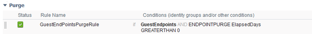

When an endpoint first 'registers' as a guest via the CWA flow, the MAC address should automatically be associated with the Endpoint ID Group configured in the Guest Type referenced in the Guest Portal configuration (default is GuestEndpoints).
You can use this Endpoint ID Group in your AuthZ Policy to authorise the registered endpoints and use the Endpoint Purge Policy to delete the endpoint for 'ElapsedDays GREATERTHAN 0'. This would force the user to be redirected to the CWA portal after the endpoint is purged.
Example AuthZ policy:
Example Purge Policy:
