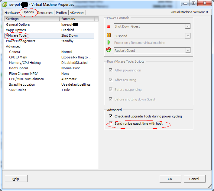

I meant that for the same reason, policy servers lost communication/synchronization with AD. Network has a NTP servers.
Problem was solved removing check mark (uncheck) from: "Virtual Machine Properties / Options / VMware Tools / Advanced / Synchronize guest time with host" (see screenshot).
Try it.
Thank You Andrey. I double checked the setting and it is as you recommended. The guest is not syncing with the VMWare host. I still cannot get the ISE to sync with the NTP server. Even though the server is in the sh ntp output as more reliable and Stratum2. When I add the NTP server during setup of the ISE I do not get an NTP sync error.
