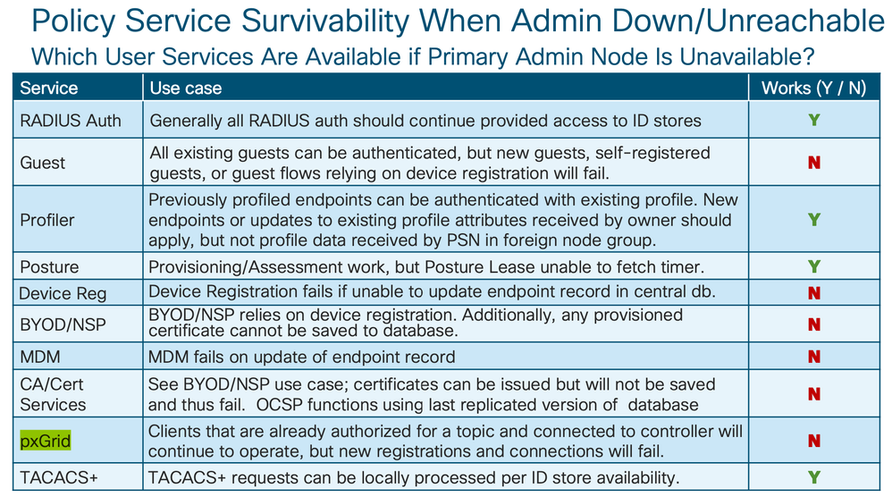

That table does not provide the full details, so it is a bit misleading. See the following table pulled from the CiscoLive BRKSEC-3432 session. The MnT node publishes the session directory to PXG nodes.
Hi Greg,
Thanks for the inputs. I will further test this out in the lab to understand the behaviour.
Rgds
Eng Wee
