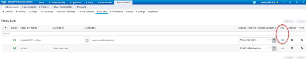

In one test scenario, I have a device that uses digital certs to authenticate for device/network access for 802.1x where I intentionally use invalid certs so that it fails authentication and I use mismatched shared keys between ISE and the device. Upon doing my tests, when going to Operations > Radius > Live Logs, I see some error counters.
I also go to Work Centers > Network Access > Policy Sets, and here I can see some counters too.
Question 1:
Are there other locations in ISE where I can see radius error counters for failed authentication issues between ISE and a device? Or is the only place to look is where I took screenshots above?
Question 2:
I noticed that in the policy set section, the counters increment when the 802.1x authentication is successful, but I also see it increments when the authentication fails. Sometimes, I see the counters don’t increment even with successful or unsuccessful authentication.
Is this expected behavior?
I would have thought the counters here increment only when they match the policy sets and are successful but not when they fail.
