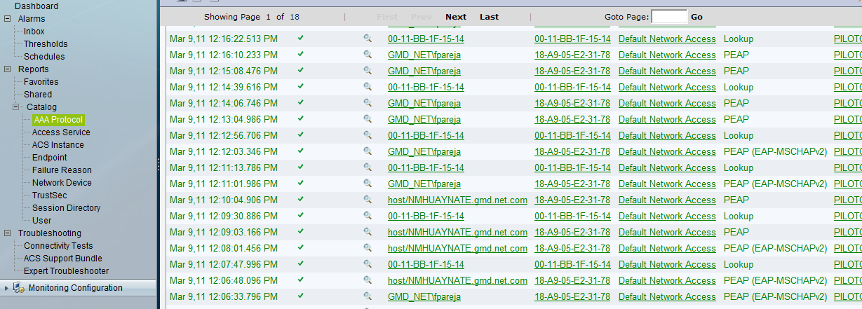

I have a questión about radius authenticaction with AD, when I log in into the network with user in AD and I make a mistake in password my radius authenticaction event in ACS 5.2 dont show me this logg. only show the authentication succeeded but dont show me the authentication failed. Maybe i must to enable same service to show the authentiaction failed. The Voice authetication works fine..

When you type in the wrong password do you see the login fail on the device you entered it? Depending on how you have configured fallback mechanisms on ACS, an attempt can still be permited eventhough the authentication failed.
It would be best to take a look at the authentication steps under the RADIUS authentication log for an attempt you beleive should have failed to see what ACS is doing with the request.
