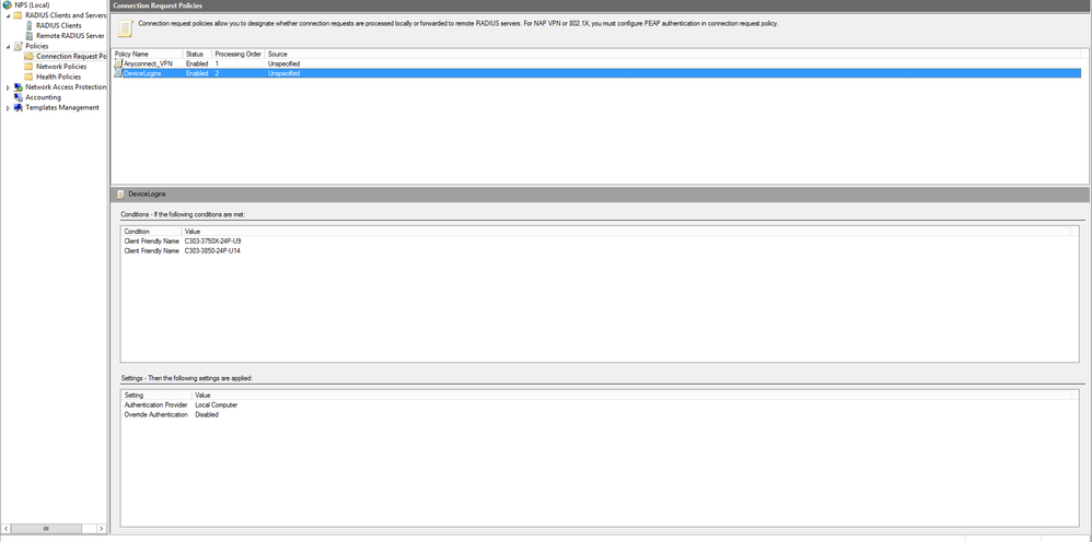

Hi all,
My question is in regards to configuring a NPS on windows server 2016. When I attempt to add multiple devices to the Connection Request Policy that I have configured it seems to break the authentication process. It would seem that I need to create an additional Connection Request Policy for each device?
Can anyone please let me know if this is normal or perhaps my configuration may need some fine tuning?
Thx

Not exactly sure what it is that you want to see, but heres some screen shots...NPS1.PNG
First screen shot is of the connection request policy with only one device allowed
Second screen shot is a successful ssh session established using the above configuration in the NPS server.
Third screen shot is of the connection request policy with an additional device added to the policy.
Last screen shot is of a failed SSH connection now that an additional device has been added to the connection request policy.
Also let me know it there's anything else more specific you'd like to see.
Thx!

Oh now it's clear to me. The screen resolution is a bit fuzzy but I think I see what's goingon.
You have two Conditions that are implicitly joined with an AND operator. This means both conditions have to be true for the Condition to be met.
I would say the solution would be to create two Policies, one per device type. Each Policy only checks for a single condition.
If a policy does not match then NPS will try the next - top down approach.
Why do you need to treat these two devices differently? Do they require different RADIUS attributes because of their name/model/location etc.? If not, then stick with one policy and make the condition less restrictive, to allow it to cater for both device types.

Arne, thank you for the reply. I think I understand what you're saying with regard to the conditions, but I'm not entirely clear as to what the operator would be in this instance? For example the condition would be the Client Friendly Name with the value of the hostname for the switch, router, asa etc... and the connection request policy would be the operator itself?
To answer your question I don't need to treat these devices with different privilege levels or anything like that. I was just trying to avoid having to make a separate connection request policy for each device.
Just to be clear on your last statement; You would suggest making the value of the condition of the client friendly name more generic so that it will match multiple devices? Perhaps by using regular expressions as suggested by @Baconframe ?
Does anyone have a working example of this technique? I'm just not particularly well versed with regular expression...

Just trying to use the NPS to authenticate users that want ssh access to devices against AD and allow users that pass this authentication to receive privilege level 15 once authenticated.
The "or" operator of | seems to be working. I have a fairly small environment of less than 20 devices. Ideally I will become familiar enough with regular expressions to make that syntax more streamlined in the future but this work for now.
