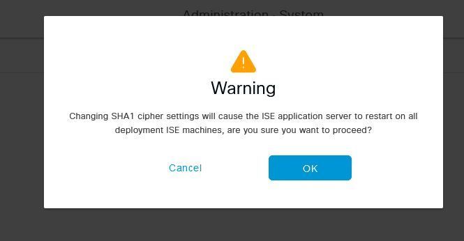

@Moudar you can force Cisco ISE to display the invalid usernames. To do this, check the Disclose Invalid Usernames check box under Administration > System > Settings > Security Settings
Should it restart the whole machine?
What is under INVALID is not important just in this case! the important is to know what is that Id; user?
@Moudar why are you changing the SHA1 cipher settings? thats not the setting that was suggested to change.
Disclosing the invalid username would reveal the user identity in the logs, which might provide a clue. Disclosing the invalid username (as per above suggestion) will not require restarting services.
What type of device is the NAD - 10.128.2.8?
You can take a packet capture (tcpdump) on ISE, setup a filter on 10.128.2.8 and determine what attributes are being sent.
When i try to activate "Disclosing the invalid username" click on Save then that about SHA1 came after!
