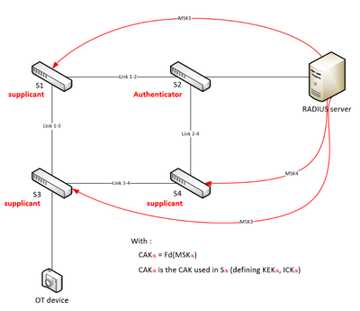

I'm working on MACsec in an industrial context and after a first stage based on static keys (PSK for CAK) I need to automate the key management. This is why I try to understand MKA protocol and 802.1X.
For availabity reason I have never used 802.1x at all !
In a basic scheme I've a PC (supplicant) want to reach a LAN through a switch (authenticator). The switch deals with a AAA server with informations provided by the PC to know if the connexion could be accepted (controlled port)
In my context I don't have such basic scheme : I use MACsec, switch-to-switch, ring (RSTP, MRP, REP, ...)
My understanding is today that the switch directly connected (s2) to the AAA server is the authenticator and others switches (s1,s3, s4) are supplicants (I'm not very sure of this first step).
At the end of 802.1X/EAP-TLS mutual authentication I should have a shared (unique) MSK only between 1 supplicant (e.g. s1) and the AAA server. By derivation the MSK will give the CAK. To communicate using MACsec at least 2 switches (in my example s1 and s3) must have the same CAK therefore the same MSK (as the kdf is the same)!
[s1] --------[s2]-------[AAA server]
  |       (ring)     |
[s3]---------[s4]
[OT device]
I should have missed something (about MSK I assume) ! Thus I need your help to clarify ...

Each switch to switch macsec link operates independently in terms of authentication and key derivation. During the 802.1X/EAP-TLS process, each supplicant (s1, s3, s4) authenticates with the AAA server (via s2 as the authenticator), and each authentication results in a unique MSK between the supplicant and the AAA server.
From this MSK, a CAK is derived for the specific link, and the MKA protocol uses the CAK to generate a unique SAK for encrypting traffic on that link...
For secure communication between two switches (s1 and s3) via macsec, both switches need to authenticate and establish their own CAKs with their respective peers in the ring. The encryption and key management are link-specific, meaning that s1 will not share its CAK (or MSK) with s3 unless they directly authenticate and form a MACsec link.
To enable end to end encryption across the ring, each pair of directly connected switches must independently establish macsec secured links. Therefore, the CAK is not globally shared among all switches, as it is derived per authenticated link.

What I understand from M02@rt37's answer :
Here, considering the link 1-3, S1 will work with KEK1 and S3 with KEK3. I don't understand how S3 will be able to decrypt the aes key sent by S1 and encrypted with KEK1 without knowing KEK1 ?
This should work because it is written in the standard, and you are probably right but I don't understand how. If someone can help me understand? There should be something shared between 2 switches to be able to derive the same keys (ICK, KEK) for me... but I can't identify what.

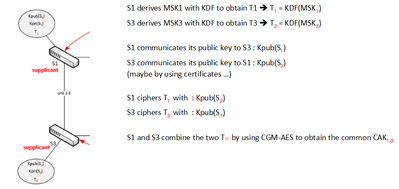

[From what I understand]
The two switches perform an authN with the radius server and they each receive a different MSK. From this MSK, each of them will derive their MSK into a sort of ramdom token (called a temporary key). I don't know yet why they called it a key, which is why I use the more abstract word “token”.
This token is sent to the other switch using ASY cryptography, a bit like establishing a TLS tunnel.
The MSK is derived to protect it.
[From what I deduce]
They derive MSK because as it is a session ID it should be unpredictible ... But theorically any TRNG could be OK.
I update my own previous drawing as :
