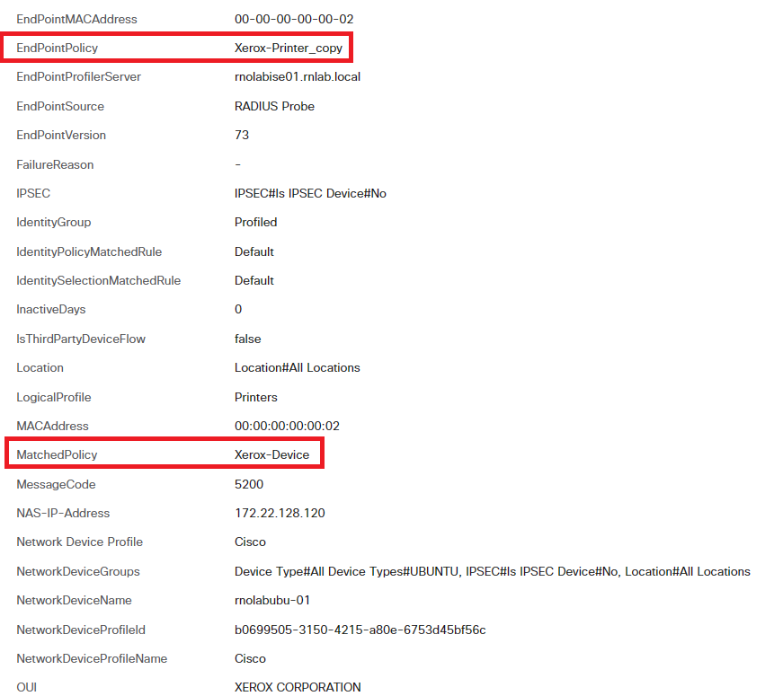

You can't set the Parent Policy to NONE because this is a Cisco Provided Policy (it's greyed out). If you clone the Xerox-Printer Policy you can do whatever you like with it. The challenge then, is to ensure that sufficient Rules in that Policy match to cause the Certainty Factor to be achieved.
I tried this, and re-ran my test. Still, Stage 1 matched, which surprised me, since the endpoint was now profiled as Xerox-Printer_copy (with no parent Policy). I noticed that the endpoint had not been re-profiled. Had it been, then perhaps it would have worked.
I then deleted the endpoint, and added the Xerox-Printer_copy profile statically, and re-ran the test. Same result. ISE profiles it as Xerox-Printer_copy but the AuthZ still matches Xerox-Device. i give up.
