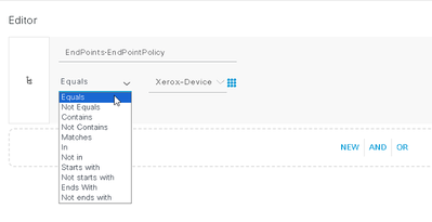

At this point we try to give the device RESTRICTED Access using MAB for Authentication and a specific DACL which only allows common network services (like DHCP, DNS, SNMP, etc.) and access from and to the ISE deployment (for NMAP scanning, etc.).
To achieve this we try to use the EndpointPolicy attribute in the Endpoints dictionary:

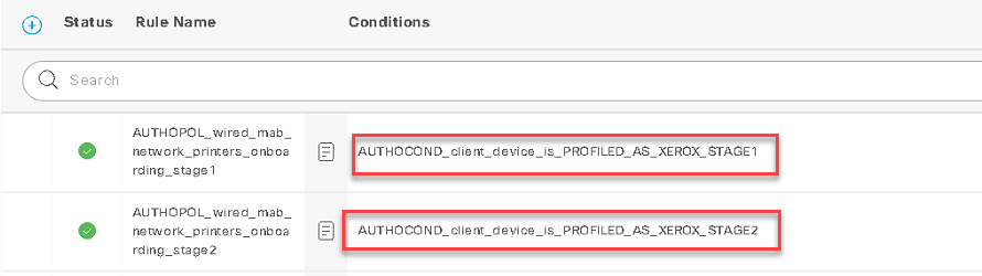

Both of the stages are referenced in one authorization rule:
And here is the problem:
No printer device will ever reach the Stage 2-Rule, because the condition of phase 1 (EndPoint:EndPointPolicy EQUALS Xerox-Device) always catches, no matter if the device has already been profiled more detailed  !!!!!
Why might that be ?? I thought, that the operand EQUALS only hits, when EXACTLY the same EndPointPolicy String is present ... ???
Here it seems that EQUALS also means CONTAINS ....
Which operand is correct here ???

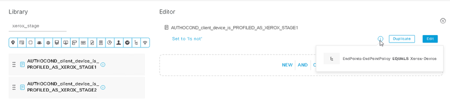

The only mystery now is to see how you defined those Conditions - can you screenshot those for us? I don't like using compound conditions unless it's a condition I re-use elsewhere. If the condition is unique, then IMHO, all it's doing is making the ISE Policy more unreadable, because you have to go hunting to find the details. Yes, the name says it all, but that is just syntactic sugar - it's not helpful in understanding and proving the correctness of the condition.
Well, the conditions are like this:
Stage 1:
Stage 2:
