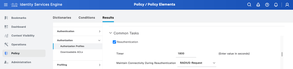

What are your ISE Authorization Profile settings? Did you mistakenly set the Reauthentication Timer to 20 seconds?
I would consider the default of 1800 in ISE as an absolute minimum and suggest 3600 (1 hour) and preferably 28800 (8 hours).
