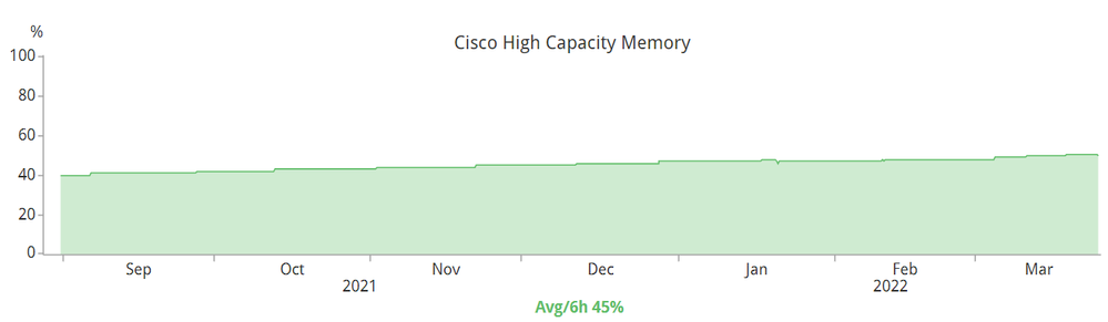

Let me share you what I have now.  Look at the picture below:
sh process cpu historysh process cpu history
This is a stack of 9300, IOS-XE version 16.12.5 and an uptime of >120 days.  Looks good, right?  Well, this picture is very deceiving.  The above picture is the memory utilization of the "entire stack".
Compare the above picture with the one below:
Normal memory leakNormal memory leak
Same stack, but the above picture is from a switch member of the same stack.  This is telling me, since September 2021, there is a slow memory leak from September 2021 until February 2022.  And starting from March 2022, the memory leak have increased.
Trust me when I say this:  This is not the "worst" switch/stack.  I have worst than this.  I use this as an example because this is more "visual" than the others.
