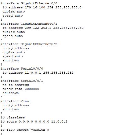

I'm experiencing 'request timeout' when trying to ping external destinations from my network. The issue occurs when ACLs are enabled on my router. It's perplexing as to why this happens. Any suggestions or insights on resolving this issue would be greatly appreciated.
Here my network (its for school) :
So basicly i've been asked to denies tcp connection from outside but allow from inside (sorry for english i'm French)
R_Int config :
FAI config :
Thanks in advance.

I have tried other ACL conf for access-list 102 like :
access-list 102 permit tcp any 201.49.10.0 0.0.0.255 established
access-list 102 deny tcp any any
or :
access-list 102 permit tcp any 192.168.0.0 0.0.0.255 established
And as always when the acl is not here i can access my server web but when i put the acl i have "request timeout"
