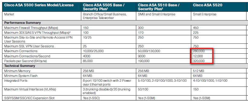

Within the ASA logs i see a lot of FIN TIMEOUTS. Source my mobile device on port 50973 --> Destination the Webserver on Port 80.
Could i handle this issue by enabling flowcontrol? Which watermark values i should use? Or is the ASA with its specs not performant enough to process the traffic that occurs?
