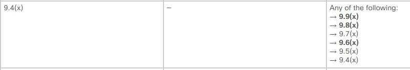

There are several questions on these support forums regarding upgrade paths. This link has been shared a lot. I have read it, but I still have a question/concern.
We have an active/standby failover pair of 5525-X ASAs currently running 9.4(4)16. Typically the way I have zero-downtime upgraded them is to put the new code on both and set it to boot from it, then reboot the standby so it comes up with the new version. Then make the standby active, and reboot the formerly-active one.
I read long ago that a running pair should always be within 0.1 versions of each other (notwithstanding the 8.4-to-9.0 upgrade ). Is that not true anymore? The link above indicates 9.4 can be upgraded directly to 9.9. That means that the standby can be running 9.9 while the active is running 9.4 for a time and still retain stateful failover?

May i know if you still achieve a zero downtime (TCP sessions not dropped) when you upgraded from 9.4 directly to 9.9? I'm planning to upgrade from 9.6(4)8 to 9.9.2 directly.
I never did. We're still at 9.4.x and I've just been doing the incremental security updates. It's still a “suggested release” on Cisco's ASA software page.
you can upgrade from 9.4.x to 9.9x

I know my configuration is correct--I wasn't asking for clarification on that. I was asking if anybody knows if you can upgrade from 9.4.4 to 9.9.x, which apparently nobody does.
here is the cisco upgrade path recommendation.
seems you can easy do a upgrade to new version.
https://www.cisco.com/c/en/us/td/docs/security/asa/asa99/release/notes/asarn99.html
please do not forget to rate.

My personal frustration is that there is no single document that indicates both a zero-downtime upgrade AND version-specific info in regards to 9.x upgrades beyond a "point one" version. The one you sent a few times indicates one can upgrade from 9.4 to 9.9 (as well as a whole bunch of other options in the grid), but it does not indicate zero downtime during that upgrade. Anyway, I'll eventually just have to bite the bullet when Cisco discontinues support for 9.4.x, but until then, I'm in no rush. I wish I had a spare failover pair, but we don't have that luxury (I do have spare 5510 ASAs, but those won't run anything newer than 9.1).
