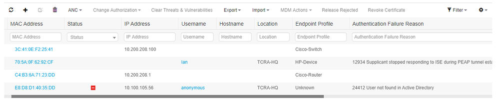

I have implemented some policies on Cisco ISE but it is using default policies instead of the ones i configured.
Can i please get help on it.
I have attached the the image below
22 Replies 22
The first PC i was troubleshooting is called Ian after enabling the disclosed invalid username it displayed the name Ian when connecting and the details as well as in the below screenshot.
But for the PC that's part of the domain, it is displaying as anonymous and when connected to the same port 10 on the switch it is bringing u the anyconnect pop-up
Ok i realized where the issue is. I havent done the certificate part yet and im facing issues binding the certificate signing requests.

The username is hidden, select the disclose invalid username option as per screenshot below.

12934 Supplicant stopped responding to ISE during PEAP Tunnel Establishment
This error message is simply because your Trusted Certificates do not contain the root certificate of the client certificate. ISE's Trusted Certificates should contain the Trusted Certificates on the client. It is used to create SSL. The client couldn't get get to the authentication stage because SSL tunnel could not be created because one side is missing proper certificate.
