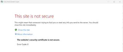

02-07-2024 03:49 PM - edited 02-07-2024 04:11 PM
Followed these steps while connected to the device over a VPN connection. After running the cloud update, I tried to deploy changes then lost connection to the VPN. Now I am getting a certificate error when I try to login to the VPN. The certificate error is preventing DUO authentication so I am not able to login to the VPN.
