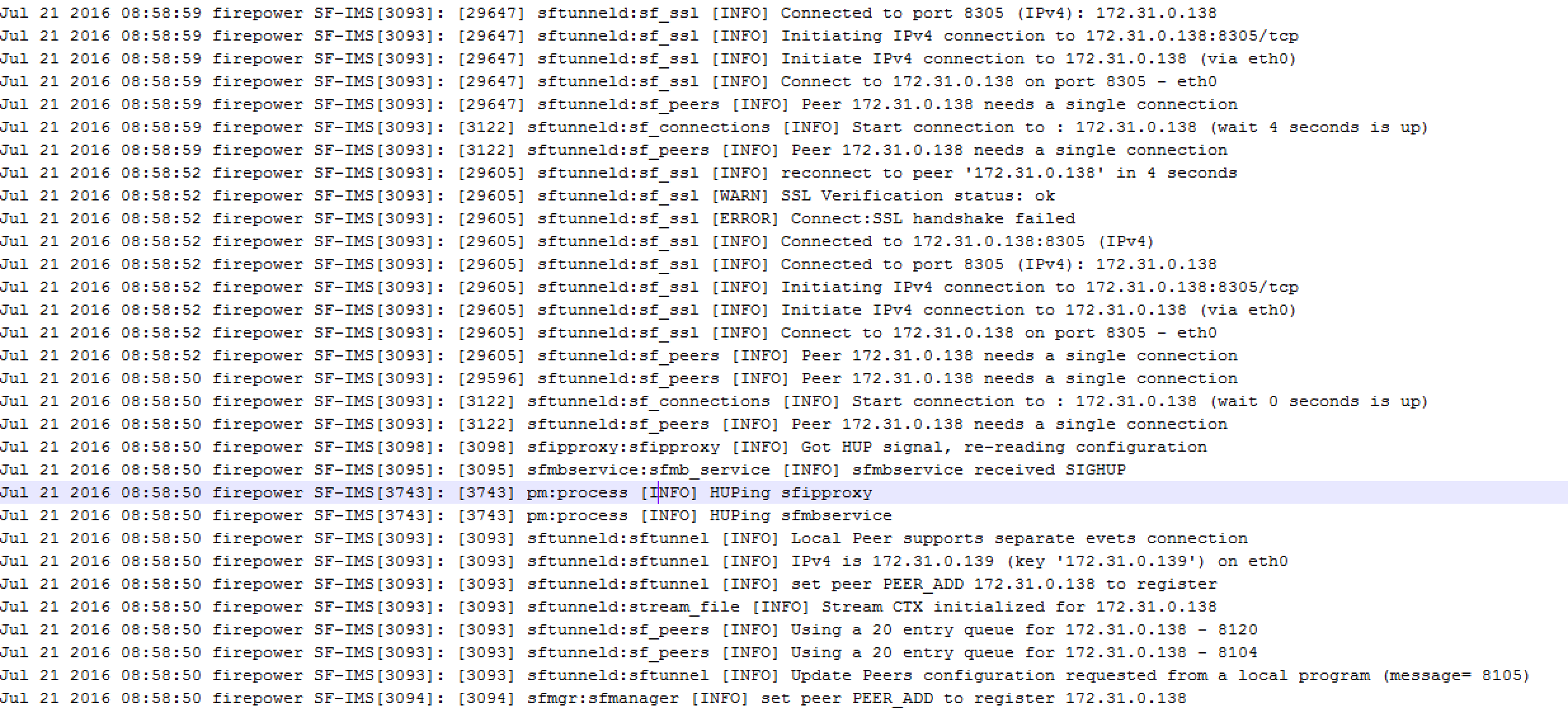

I am trying to add a firepower device in firesight and every time I receive the following error:
I check the logs and its giving me some sort of ssl handshake error that I googled and couldn't find any definitive resolution, Has anyone see this? Know how to fix it? This is a new firepower and firesight installation. There is IP connectivity between devices, they are on the same network, no nat, and no firewall between them.

Thanks for the reply Jetsy - I followed your recommendations and I am still experiencing the same issue. Any other ideas? FYI - I also just updated firesight to ver: 6.0.1
