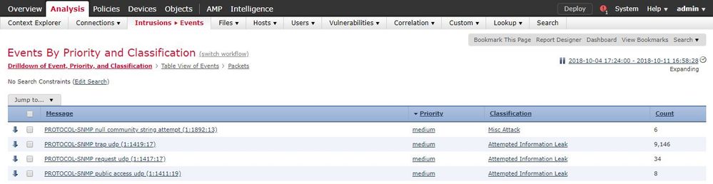

Hello
I could fix this, I will share my config in order to help someone.
It's important to apply the Intrusion Policy on the access rule, because if traffic matches, it does not apply the default IPS policy.
Oh, and I had to reload the device too!!!!
And rememember to enable the rule, (maybe) it is not enabled by default.
Here they are:
