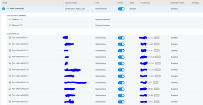

I leave a picture of the configured subinterfaces in my portchannel on the Firepower.
I am trying to ping these addresses from a switch, but only one of them responds since it is the management one and it is directly connected.
As for allowing the traffic in ACP I don't have it, I am somewhat disoriented with that since it is my first time working with Firepower, any idea how I should do it?
regards.
Right, that's to be expected. If for example you are connect to interface 20.211 and attempting to ping 20.212 FTD interface IP address, that won't work and it's not possible to override - by design.
You can ping "through" the FTD, but you cannot ping "to" one of the FTD's far interfaces. Test connectivity by pinging "through" the FTD, from one vlan to a device on another vlan, but don't ping the FTD's interface. To ping "through" the FTD you will need the ACP rules configured to permit the traffic.
