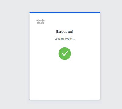

I am using a FMT locally as in an airgapped environment. I load the tool complete the SSO with my account but the FMT screen remains greyed out..
2 Replies 2
from the last window it looks like the full login did not go through..
have you tried it from a non air gapped network with full internet access to see if it works fine as a test ?
also you can try to open a browser developer tools (google it) and see if its failing anywhere.. it may give you more insight..
Nishad
Hey, for air-gapped environments, CCO login won't work. You can request a TAC to get the offline version, which is developed specifically for air-gapped environments.
