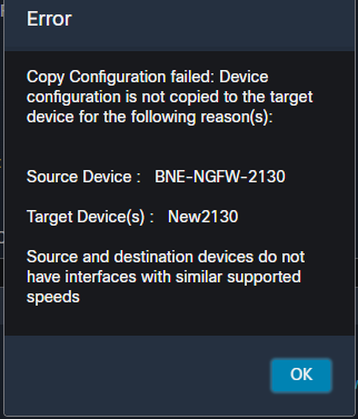

So, i go to our customers office to test it with their spare 2130 unit, and perform all the same steps and was greeted with this error. I am unable to find ANY information on this in the documentation or even looking around on google or reddit. We checked multiple times and can confirm that the interfaces are configured EXACTLY the same between the units.
The only difference is that the units are about 4 years apart in age. However i dont know if that would make a difference. Al of the speed configurations on the interfaces (and all other tabs for that matter) are exactly the same between the units.
So, im at a loss here. open to any suggestions if you have them @Marvin Rhoads

You cannot restore a 1010 configuration onto a 2130 device. The backup / restore process requires the exact same hardware.
Otherwise you will have to build the device-specific settings from scratch (basically anything that's setup under the device page tabs - interfaces, zone mapping, routing, license assignment etc.).
Na, I went 1010 -> 1010 in my test environment. That worked as expected.
I ran into the interface speed issue when doing 2130 -> 2130
Re-reading my post, I understand how it seemed I went 1010 -> 2130. But it was all the same model migrations.
There were some changes in the 2100 series interface definitions that I recall would lead to some cosmetic error messages on FMC after upgrading even a given appliance. I recall they were related to some default commands Cisco changed per interface. Even though the capabilities are the same across releases, how FMC parsed the running-config changed. You may be hitting a previously-unknown symptom of that bug.
Hi marvin. Of course there is. Why is nothing ever easy with these firewalls. Even the simplest things are a mission to complete. Haha.
Do you by chance have any recollection of the details of this bug so i can look for more info on it?
Hi Marvin, thanks for that.
After investigation looking through a ```sh int```, we noticed that one of the interfaces on the SOURCE was set to 100MBPS (although the interface setting in FMC was AUTO) and when replicated to the TARGET, it was set at 1000MBPS.
We manually assigned the TARGET interface down to 100MBPS to match, and even after multiple deploys it did not work, We are now going down the manual path of applying the configs and policies, and not using the config push / pull.
Thanks for the assist though.
