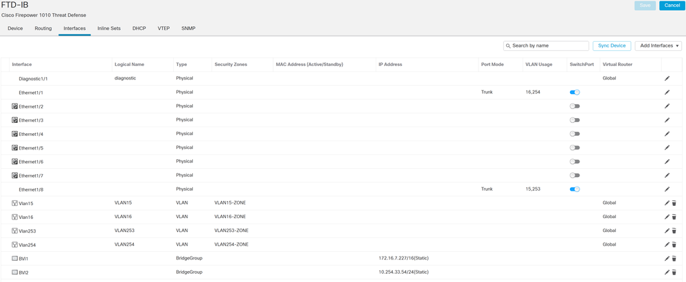

I've updated the interface, vlan, and bvi configuration for one FTD.  If I am understanding correctly, then this should be right.  I'll need to go to the building site to configure the switch real quick then I can test.  BVI 1 has vlan 15,16 and bvi 2 has vlan 253,254.FTD-IB (Int changes).png
Yes that looks correct, and yes you will need to amend the switch configuration to allow for the new VLANs.
As for the BVIs you do not need IPs on them for them to work.  I have always had IPs on the BVIs as it helps me read  and understand the traffic flow better.
