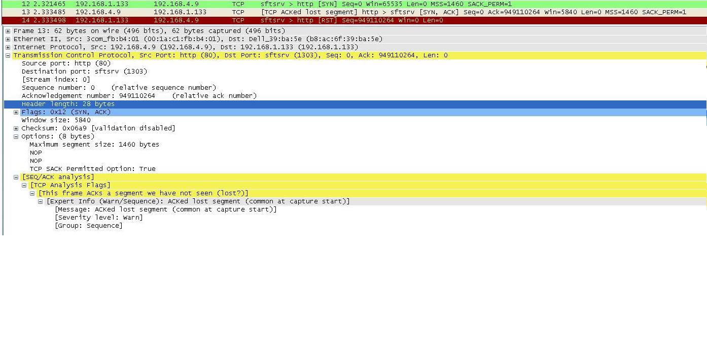

I am using ASA 5510 and I have a specific problem with Http Connection to receive a video Flow ( RSTP protocol ) in the LAN.
Some Pc users (192.168.1.133,in the log)  with ASA Lan Interface as gateway can ping the Camera but don't receveive the video flow.
Some Pc users (192.168.1.116,in the log) using another gateway can ping and receive the video flow.
I used Whireshark  to capture traffic between camera and Pc using the 2 gateway. I joined Logs with this message.
It seems to be a problem of TCP segments on the ASA, I try to changed some TCP options but it's still the same:
- Disable Force Maximum Segment Size
- Enable Force TCP Connection to Linger in TIME_WAIT State for at Least 15 Second
Should I enable RSTP inspection for example ? Any Others Ideas?

That's why I ask here why the TCP connection doesn't work when PC use ASA Firewall as gateway whereas the ping is Ok.
Wireshark shows:
Acked Lost Segment /  Broken TCP. The acknowledge field is nonzero while the ACK flag is not set
I was wondering if ASA had  Security options with TCP connection which explain the deny traffic

I try to search other possibility :
When it works (pc using a different gateway), wireshark indicate this msg : Tcp segment of a reassembled PDU.
By default,Is the ASA accept and fragment frames larger than the MTU size ?
And what about the Timeout tcp-proxy-reassembly option ?
