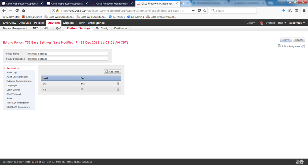

Documentaion indicates I should see a Syslog option under Devices -> Platform Settings.  But I don't get that option in the Contents pane.

on same secreen you showed go to Audit log its on the left pan. in that it will show you  the option for syslog.
please do not forget to rate.
My understanding is that will send the audit logs to the syslog server.  But I should see a Syslog option, according to the documentation and screen shots I've seen, on the same menu as the Audit Log.  That Syslog option is what would allow me to send all Connection events.
Abheesh Kumar
Global Syslog configuration in platform settings is only available for FTD's not for ASA-Firepower modules.
For ASA-Firepower modules you need to enable syslog in each ACP rules you created.
