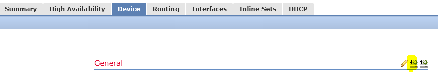

From FMC, Devices, select the device,  From General click Get device config as mentioned below.

Hi Balaji,
Many thanks.
However clicking on the Get device config, am not still able to get the device configuration itself, rather it is trying to get the configuration from another device to the device.
What else do you suggest i do?
Did your FMC manage many FTD devices ? make sure you select the correct device to get config.
