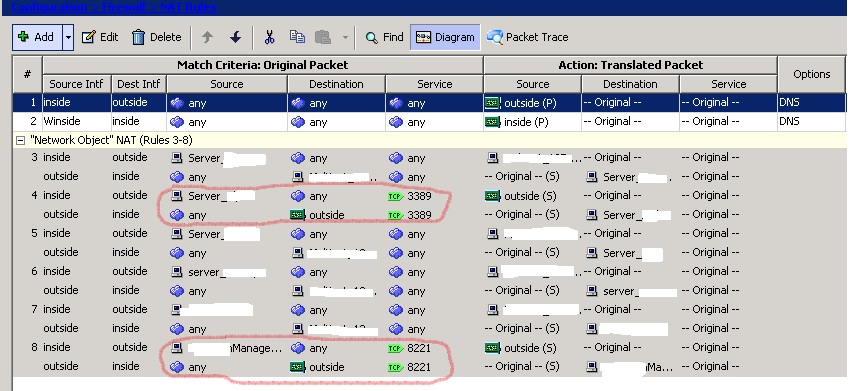

Dear All,
I have ASA 5506x (Firepower) firewall. we have multiple public servers inside network. i have configured public server in firewall in "PUBLIC SERVER" section against live IPs. all are now accessible from outside on specific ports. the issue is :  when i simply use NAT against only one object say "Alpha_Server (192.168.81.14), and i enable port forwarding on specific tcp port like rdp 3389, and bind it with firewall outside interface, and also enable acl rule on outside interface,  but it didnt work. and according to the packet trace, Action is drop "Config Implicit rule".
1......is this due to implicit rule or what? and i think implicit rule should not block the incoming request when i have acl for permit against specific port.
2......but when i use PUBLIC SERVER section it allows all desired ports accessible from outside . which means live IPs are ok. and when i want to save my live IP and want to use outside interface IP, i cant do port forwarding.
whenever i tried to contact alpha server from outside, there is even no hit counts as well....!!!!
any idea....!!!!

i am attaching jpeg's of asdm for your review.
