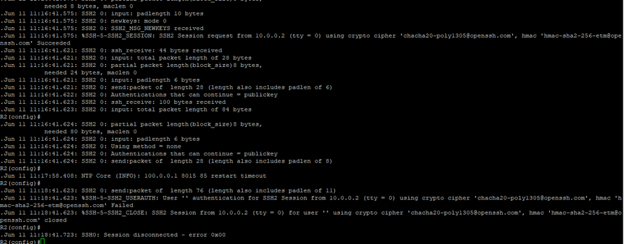

and I get the following:
I do not see anywhere the router receiving the certificate from the PragmaClient, or verifying it against the CA trustpoints. The thing is that the SSH client seems to be reading my smartcard because it uses as the username the Common Name field of the ID Certificate of the smartcard:
