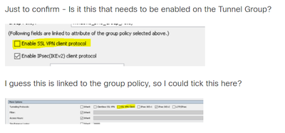

Just to confirm - Is it this that needs to be enabled on the Tunnel Group?
I guess this is linked to the group policy, so I could tick this here?

@is.infrastructure1 correct. If there is a newer client pending on the ASA, it will try to update but without client services (which require SSL/TLS) the update will fail and prevent the connection.
