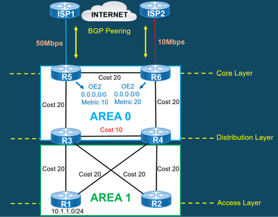

In this topology, a company has two internet connections with different speed and BGP peering with two ISPs. In order to provide internet connectivity, we need to advertise a default route from the edge routers into OSPF domain, and for better user experience, the path through ISP1 should be preferred. To do that, the router R5 is configured to inject a Type-5 LSA with a metric 10 while R6 advertises a Type-5 LSA with a metric 20, making R5's default route the preferred one.
All links from the access layer to the core layer has a cost of 20, except for the link between R3 and R4 which has a cost of 10.
A vlan subnet 10.1.1.0/24 behind the access router R1.
For scalability and optimization, we decide to move to multi-area design, where the core network with routers R3, R4, R5 and R6 are in the backbone area, while the routers R1, R2, R3 and R4 are in area 1, making the distribution routers R3 and R4 the ABRs.
When designing this type of architecture with full layer 3 between the access, distribution and core layers, the link that connects directly the two ABRs must be designed carefully. The question that arises, where we can put the link R3-R4? in area 0 or area 1?
The first scenario with link R3-R4 in area 0.

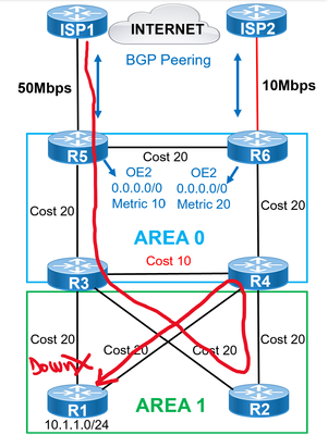

Finally R3 prefers the intra-area route through R2 over the inter-area route through R4, causing a suboptimal routing in the inbound traffic, the inbound packet from Internet to 10.1.1.0/24 will take the path R5-R3-R2-R4-R1, instead of R5-R3-R4-R1.
While the computed path from R5’s perspective is R5-R3-R4-R1, the router R3 is hijacking the traffic because the independent SPF computation and route lookup that intercept the packet.

R4 will install an external default route with next-hop R6. The outbound packet from 10.1.1.0/24 to Internet will take the path R1-R4-R6 then to ISP2 with low speed causing a suboptimal routing.
While the computed path from R1’s perspective is R4-R3-R5, the router R4 is hijacking the traffic because the independent SPF computation and route lookup that intercept the packet.
