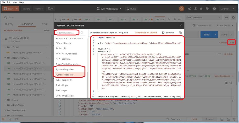

Also would like to point out this you can get the code by any kind of language as you like through these steps, for example, will choose python and edit the script through IDLE.
