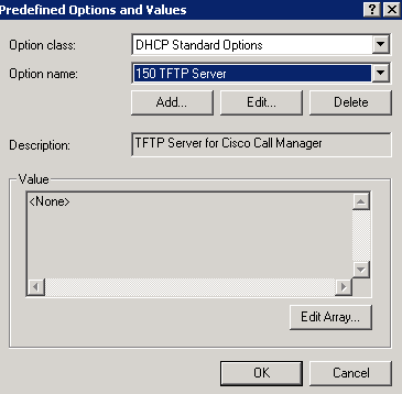

Solution
  • Delete the TFTP Predefined value from the Microsoft Windows DHCP server.
  • DHCP Server > IPv4 > Right Click > Set Predefined Value > Search for Option "150 TFTP Server" under Option name Drop down >  Delete.  Set Predefined Option_1.PNG
  • To Add the the value, go to the same page and Click on "Add".
  • Add the Option Type with the name as "TFTP Server", Data Type as "IP Address" and the code as "150".
  • Now, configure the TFTP option for the Voice Scope. Goto DHCP Server > Scope configured for Phones >  Scope Option > Right Click > Configure Options > Scroll Down to select "150 TFTP Server" added above and add the IP address > Apply > Ok.
