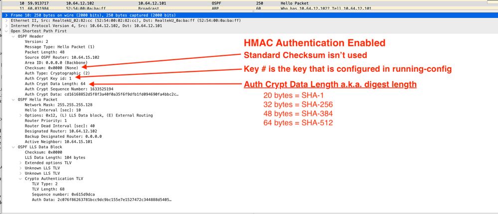

The frame below shows an OSPF hello packet with HMAC-SHA-512.
How do we know?   First, we see the standard checksum is all zeros,  next we see that Auth Crypt Data Length is equal to 64, we know from RFC 5709 that this means HMAC-SHA-512 is enabled.  Third, there are just a lot of Auth Crypt fields that weren’t there in the clear text frame.  PCAP OSPF HMAC Hello Packet.jpg
