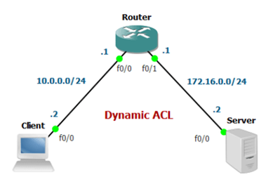

  • When the user try to telnet to the router a dynamic entry is added in the ACL that allow user traffic to pass, and telnet connection is dropped. Then user traffic will pass through the router until timeout timer expire.                                                               Gopinath_Pigili_0-1734167730914.png

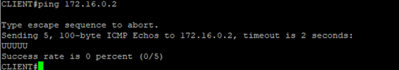

    • Now, let’s try to issue a ping from Client(Host) to Server:Gopinath_Pigili_1-1734167831416.png
      Good! That’s what we were expecting.
      Further will telnet to Router to initiate dynamic ACL entry and allow traffic to pass.
    • If you verify your ACL in Router we can see one new entry (Dynamic entry) is added, so that we can see the communication up to 5 minutes.
    • The last entry was created dynamically and allow traffic from host 10.0.0.2 (Client) to go to 172.16.0.0/24 network (Server network).
